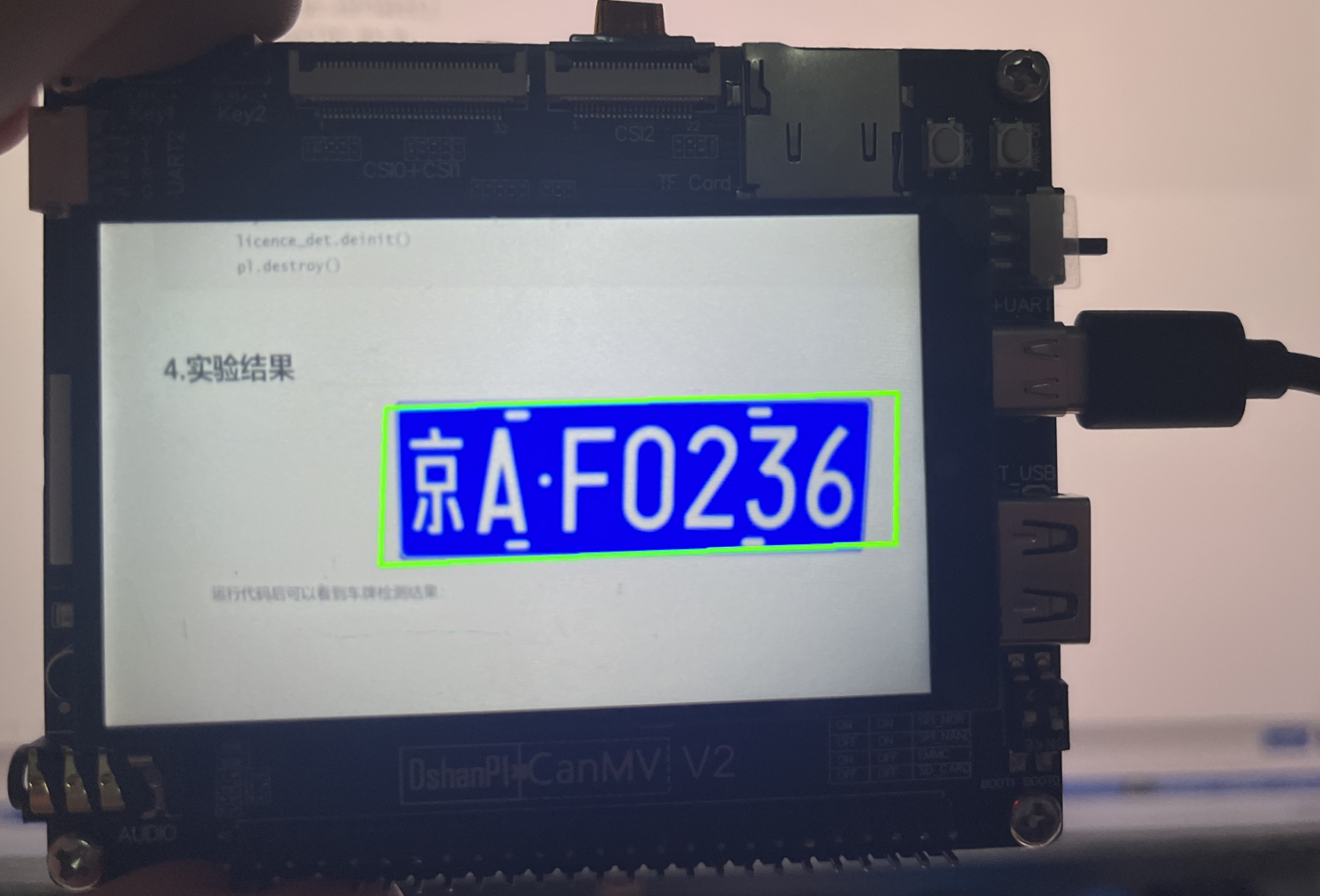

绘制结果
def draw_result(self, pl, dets):
with ScopedTiming("display_draw", self.debug_mode > 0):
if dets:
pl.osd_img.clear() # 清除屏幕
point_8 = np.zeros((8), dtype=np.int16)
for det in dets:
for i in range(4):
x = det[i * 2 + 0] / self.rgb888p_size[0] * self.display_size[0]
y = det[i * 2 + 1] / self.rgb888p_size[1] * self.display_size[1]
point_8[i * 2 + 0] = int(x)
point_8[i * 2 + 1] = int(y)
for i in range(4):
pl.osd_img.draw_line(point_8[i * 2 + 0], point_8[i * 2 + 1], point_8[(i + 1) % 4 * 2 + 0], point_8[(i + 1) % 4 * 2 + 1], color=(255, 0, 255, 0), thickness=4)
else:
pl.osd_img.clear() # 清空屏幕
